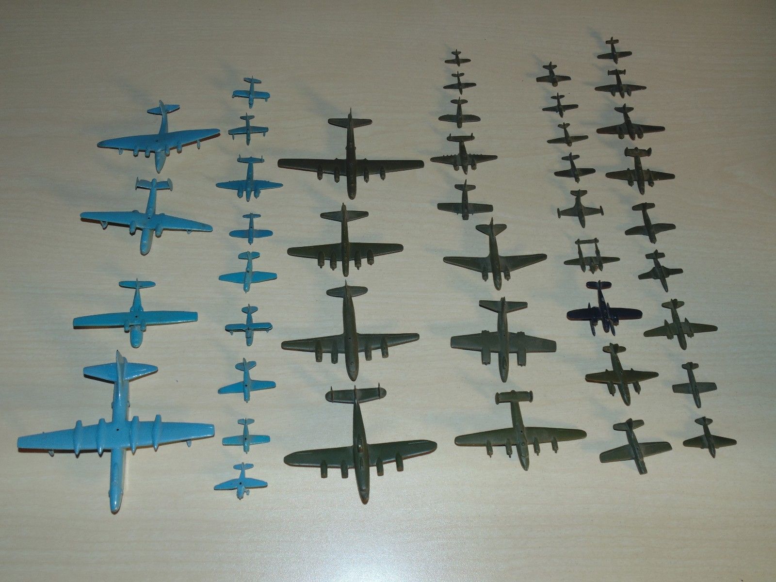

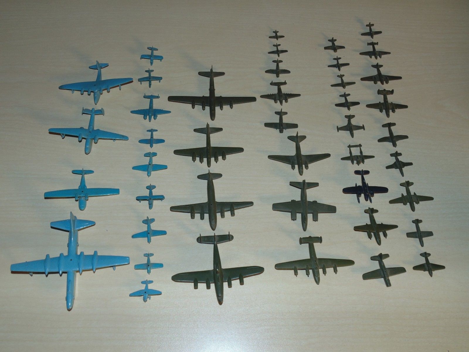

Comet Authenticast on eBay
Postby MichaelB » Mon May 30, 2016 9:10 pm
This auction item finished this past week and closed out at just under $600 which is mostly a bargain in my book, but too deep for my wallet. I sure wish I had the wherewithal to afford such things, but I'm also glad I don't!
I was impressed with there being so many rare subjects! : PBM, R3Y, B-45 and others!
Here's the link: http://www.ebay.com/itm/112007194678?_trksid=p2055119.m1438.l2649&ssPageName=STRK%3AMEBIDX%3AIT
Re: Comet Authenticast
Postby chrsn » Fri Aug 05, 2016 6:12 pm
Ah, yes! I remember that auction because of the big R3Y and B-45 Tornado that I wanted. Unfortunately, the winning bid easily blew through my max. I've since added the B-45 for a very reasonable price, but am still on the lookout for the R3Y.
It's important to maintain discipline on these auctions. You don't want to shoot the moon and get buyer's remorse when the bill comes. To pay big money, you'd better love it, not simply "like" it.
Postby MichaelB » Fri Aug 05, 2016 10:39 pm
Yeah, it just got to be toooo much for my wallet! On the other hand, this is the only sale of this size I have ever seen! Unlike the founder of this site, I don't have the cash to let for these things!
Yes - remarkable little models they are...and the R3Y?...I had no idea!
Real collector's items...
