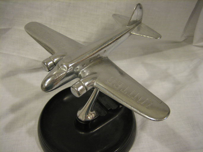

Here is a single pic of an A.C. Rehberger model Boeing 247A with a United Airlines stand. I'm showing this to ask if this is the original stand or might have been added later? Image

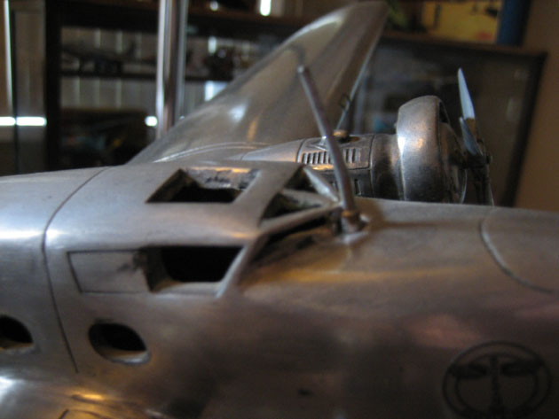

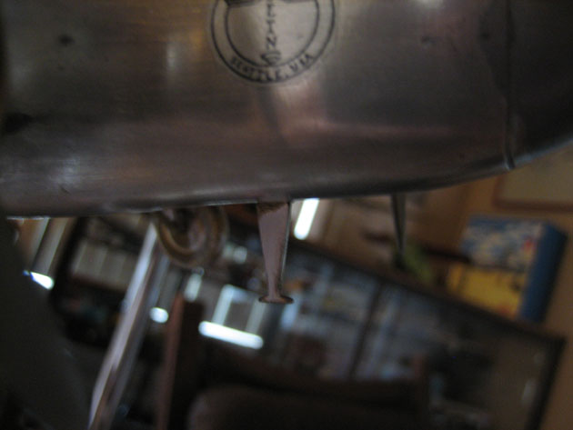

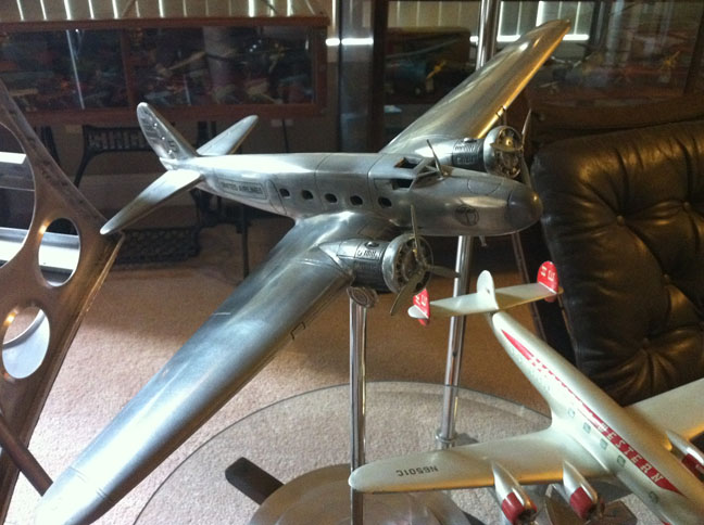

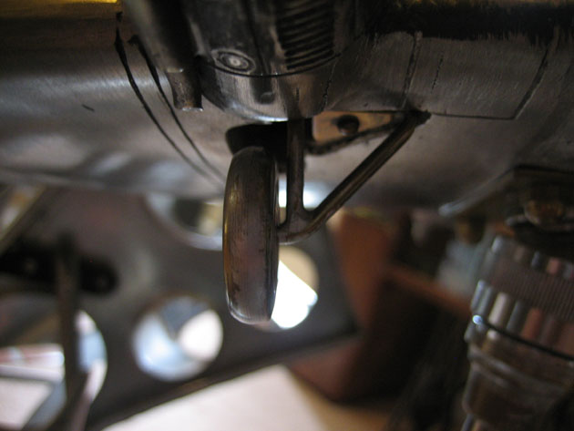

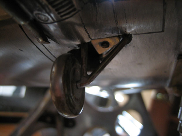

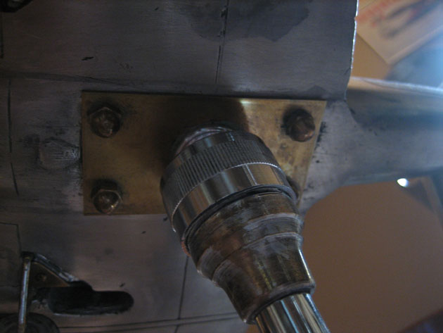

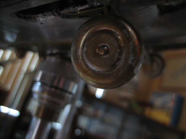

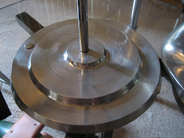

Here are some detail pics of my Rehberger B247 model with some close-ups of the parts you might be missing.
Some dimentions in metric ( I grew up in Europe, never could adjust to the US system....) : Front top antenna 26 millimeter tall (that is exposed ) . Botton pitot tube 14mm exposed, Tires are 22 mm in diameter, 4mm thick, Main gear vertical strut 15mm exposed, diagonal gear brace 27mm exposed. Base of stand is 25 cm in diameter. Retangular base attachment is 7 x 4 cm.
Hope it helps.
Terry.

I just wanted to express my SINCERE appreciation for your help and the great pics. They have been very helpful! The landing gear is about the last thing I have to do and then still trying to determine whether to do the antenna or not for fear that it might break off when I try to ship it.
